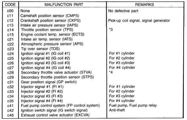

Or you could see what the problem is your self by putting the bike into dealer mode...
If your FI warning light is on you need to get the error code by getting your bike into dealer mode - dead easy; heres an explanation of how to make a switch to put it into dealer mode (dont bother with the switch just bridge the necassary wires ) turn on the ignition and instead of a flashing FI you will get an error code or c00 if everythings ok...
click on the first link "dlr/kill/security"
http://81x.com/bugman/gixxermods
then when you have the error code post here, if your bikes running fine odds are it could well be a C28 error. easy and cheap to fix (both my K1 750 and K2 1K suffered from this one - its just a simple cable replacement/adjustment)

mine flashes up witht he fi light occasionally so i done the above thanks to the advice of fastbiker. the error code is c42,anybody had this?
today it was struggling to start when this was flashing,turned the ignition off a couple times until it stopped flashing and it started fine,any ideas?

aha,just read this site
http://www.suzukicycles.org/GSX-series/ ... lems.shtml
looks like theres a bit of moisture somewhere!!

watters wrote:aha,just read this site
thats interesting - never heard of anyone suffering with a C42 before
shows how usefull the suzook FI error code table thing is mind.
